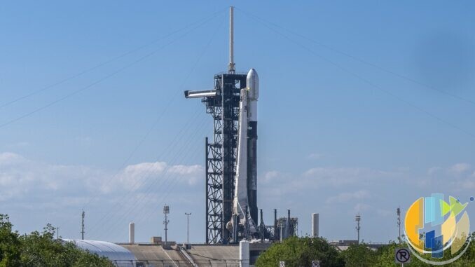

The box rode on Athena, the Nova-C lander built by Houston’s Intuitive Machines for its second mission, IM-2. Athena launched on a SpaceX Falcon 9 from Kennedy Space Center at 7:16 p.m. EST on 26 February 2025 (NASA).
Its passengers included the two customers: Grace, Intuitive Machines’ Micro Nova hopper, built to fly over the surface on thrusters, and MAPP, a small rover from Lunar Outpost. Both carried Nokia device modules.
