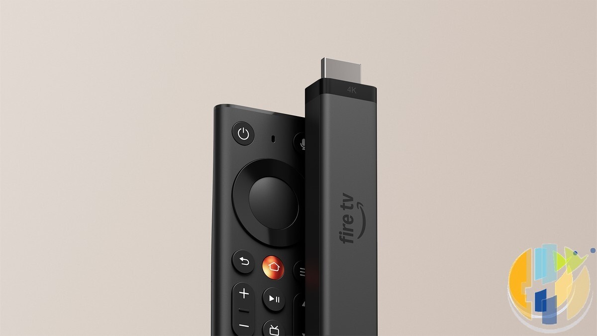

Amazon announced the new Fire TV Stick 4K on 30 September 2026, and the headline is not the speed claim or the slimmer body. It is the operating system. This stick runs Vega OS, Amazon’s own Linux-based platform, not the Android-based Fire OS that every previous Fire TV Stick 4K has used since 2018.
That one change decides whether this stick is a sensible £32.99 impulse buy or a very small paperweight in your house. If your Fire Stick is mostly Netflix, iPlayer, YouTube and Prime Video, you may never notice. If you install apps from outside Amazon’s store, you will notice on day one.

- On the box and spec sheet: a 4K stick with no Dolby Vision, a USB-C power port and a short cable for the TV’s USB socket is the new Vega model.
